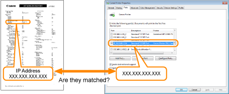

<Question 10> Is the IP address set properly?
Check if the IP address written on Network Status Print printed in <Question 4> matches the one configured for the port of your PC.
Yes, they are matched.
To <Question 11>
No, they are not matched.
Configure the printer to a static IP address.

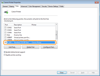

<Question 11> Is the port to be used selected correctly?
Selected
To <Question 12>
Not selected
Select the correct port.
The port to be used cannot be found.
Create a port.
