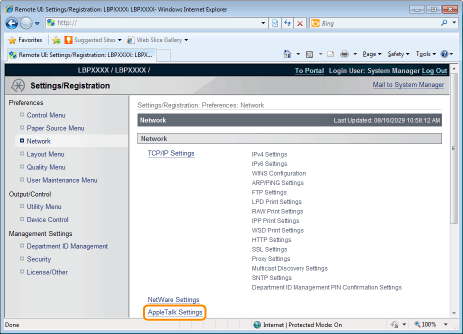

Select [Network] from the [Preferences] menu.
4
Click [AppleTalk Settings].
