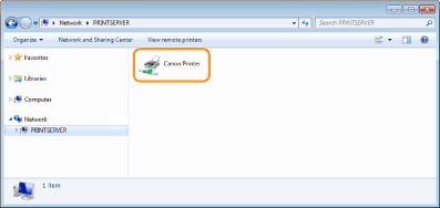

<Question 9> Is the printer on the print server displayed on the network?
Displayed
To <Question 10>
Not displayed
Ask your network administrator about the problem.
