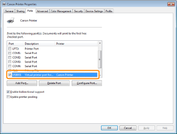

<Question 8> Is the port to be used selected correctly?
Selected
To <Question 9>
Not selected
Select the correct port.
The port to be used cannot be found.
Install the printer driver again.
For details on the procedure for installing and uninstalling the printer driver, see "Printer Driver Installation Guide."
For details on the procedure for viewing "Printer Driver Installation Guide", see "Installation."

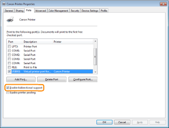

<Question 9> Is bi-directional communication enabled?
Enabled
To <Question 10>
Not enabled
Enable bi-directional communication and restart the computer and printer.
