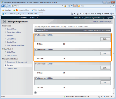

4
Click [IP Address Filter].
5
Click [Edit...] under [IPv4 Address: TX Filter] or [IPv4 Address: RX Filter].
It limits the sending of data from the printer.
It limits the sending of data to the printer.

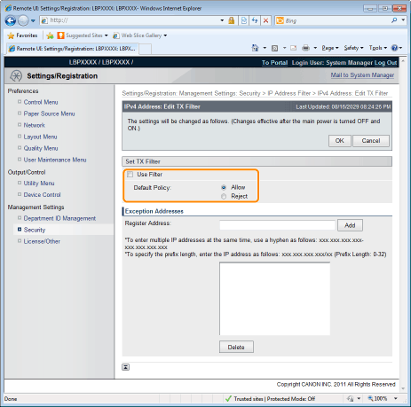

6
Select the [Use Filter] check box, and then [Default Policy].
If you select [Reject], you will only be able to transmit or print from users (clients) entered in the [Exception Addresses] field.
If you select [Allow], you will not be able to transmit or print from users (clients) entered in the [Exception Addresses] field.
If you clear the [Use Filter] check box, you will be able to transmit and print from all users (clients).

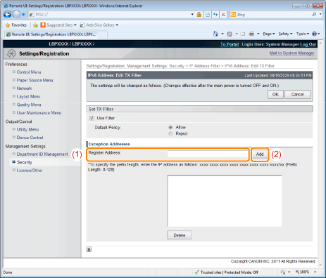

Set the IP address.
(1)
Enter the IP address for which you want to reject or permit to print.
Enter the IPv6 address, which is a hexadecimal value, by adding ":" (colons) as delimiters.
(2)
Click [Add].
You can set up to 16 IP addresses (16 sets of IP addresses for when you have specified with [Register Address]).
You can also enter IP addresses as follows.
Input example of
the IP addresses
Method for entering IP addresses
fe80::0000/64
In order to specify the subnet range (prefix length), enter a "/" (slash) after the normal IP address symbol, and then enter another prefix length (maximum 128).
When "0" is entered in [Prefix Length]
All the IP addresses become the target for rejection or permission.
When "128" is entered in [Prefix Length]
The IP address of the printer becomes the target for rejection or permission.
