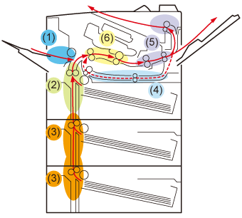

Before removing jammed paper, see "Attention (Paper Jams)."
When a paper jam occurs, the printer beeps, displaying the message <Paper is jammed.> in the display.
This section describes the procedure for when [Animated Instruction] is set to [On] (default setting).
If [Animated Instruction] is set to [Off], the following screen is not displayed.
Messages appear one at a time. Confirm all of them.
As the messages disappear when the cover is open, take a note of them if required.
Remove the jammed paper according to the displayed message.
Paper Jam Area
Message
Clearance Procedure
(1) Multi-purpose tray
<MP Tray area>
(2) Drawer 1
<Drawer 1 area>
(3) Drawer 2*, Drawer 3*
Only when the paper feeder (optional) is installed
<Drawer 2 area>
<Drawer 3 area>
(4) Duplex unit area
<2-sided unit area>
(5) Output tray/Sub-output tray
<Sub/output tray area>
(6) Inside the front cover
<Front cover>
Cleaning the feed roller may prevent frequent paper jams.
When you use thin paper (16.0 to 19.8 lb Bond (60 to 74 g/m²)), setting [Paper Type] to [Plain L] and [Special Print Mode C] to [On] may prevent frequent paper jams.
[Special Print Mode C] can also be set using the printer's control panel.
