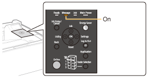

The Message Indicator Is On
08X4-0K6
When the Message indicator is on, implement the following solutions.
The Service Call <Ennn-nnnn> Appears in the Display ("n" Represents an Alphanumeric Character)
Implement the following solutions according to the displayed message.
Message
Cause
Solution
("n" represents an alphanumeric character.)
A problem occurred in the fixing unit.
Follow the procedure in "If a Fixing Unit Error Is Displayed", and then contact your local authorized Canon dealer.
A problem occurred inside the printer.
Following the procedure in "If a Service Error Is Displayed", cycle the power of the printer.
