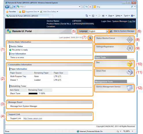

Remote UI Portal Page
The screen shown below, which is displayed when the Web browser is launched and you have logged in to the Remote UI, is called the Portal Page.
(1)
[Device Basic Information]
[Device Status]
The indicators and status messages show the current printer status. You can see the status of the printer from the indicator colors, as shown below.
Indicator Color
Printer Status
Solution
(Gray):
Offline (not accepting print data)
Go back online and print.
(Green):
Normal status (able to print)
(Yellow):
There is no printing trouble, but some type of action is required (a warning message is displayed)
Follow the onscreen instructions shown in [Error Information] below and solve the problem.
(Red):
Printing is not possible for some reason (an error message is displayed)
[Error Information]
It displays error information generated by the printer.
(2)
[Consumables Information]
[Paper Information]
It displays paper level, size and type for each of the paper sources.
[Remaining Toner]
It displays the amount remaining in the toner cartridge.
Consumables
Display
Status
Solution
Toner Cartridge
7-100%
Able to print
1-7%*1
The toner cartridge needs to be replaced soon
Printing will continue or stop.*2
If printing has stopped, press [  ] (Online) on the printer control panel and printing will continue.
Have a replacement toner cartridge ready.
We recommend that you replace the toner cartridge before doing a large amount of printing.
0%
The toner cartridge has reached the end of its life
The printer stops printing, and you cannot continue the job.
Replace the toner cartridge with a new one.
<Insert Cartridge>
The toner cartridge is not installed
Install the toner cartridge properly.
*1
Depending on the type of toner cartridge that you are using, "1-21%" may be displayed on the screen.
*2
Whether the printer continues or stops printing when the toner cartridge needs to be replaced soon depends on the setting for [Warning Step] in the [Setup] menu.
(3)
[Message Board]
It displays messages from the administrator.
(4)
[Support Link]
It displays links to information concerning printer support.
(5)
[Language]
You can change the screen display language from the drop-down list.
(6)
[Mail to System Manager]
You can send e-mail to the system manager.
(7)
Update Button
Refresh the portal page display to the latest status.
(8)
[Status Monitor/Cancel]
You can check and change the status of jobs the printer is processing. You can also check device status.
(9)
[Settings/Registration]
You can set/change the various printer settings. The items that can be set/changed differ depending on whether you log in as administrator or end user.
(10)
[Box]
When the optional SD card is installed, you can print, copy and send documents that are saved in the printer's box.
(11)
[Direct Print]
Using the printer, you can print PDF files, PS/EPS files, image files and XPS files that are saved to the computer you are using as is, without opening them.
(12)
[Service Management Service]
It displays the SMS (Service Management Service) screen.

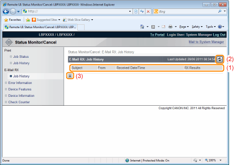

E-Mail RX: [Job History] Page
It displays the received e-mail history.
(1)
Display Job History
The received e-mail history list is displayed.
(2)
Update Button
It refreshes the [Job History] page display to the latest status.
(3)
[Back to Page Top]
It moves the scroll box up to the top of the page.

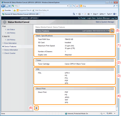

[Device Features] Page
The printer equipment information and the functions that can be used in the current equipment status are displayed.
(1)
[Basic Specifications]
The amount of RAM installed in the printer console, the installed options and the basic printing performance are displayed.
(2)
[Toner]
Information about the toner cartridges installed in the printer is displayed.
(3)
[PDL]
The page description languages that can be used by the printer are displayed.
(4)
[Direct Print]
The file formats and document formats that can be used by Direct Print are displayed.
(5)
Update Button
It refreshes the [Device Features] page display to the latest status.
(6)
[Back to Page Top]

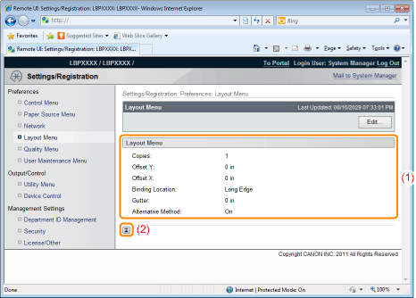

[Settings/Registration] Menu
The following pages show the settings that can be checked using the [Settings/Registration] menu.
[Preferences]
[Output/Control]
[Management Settings]

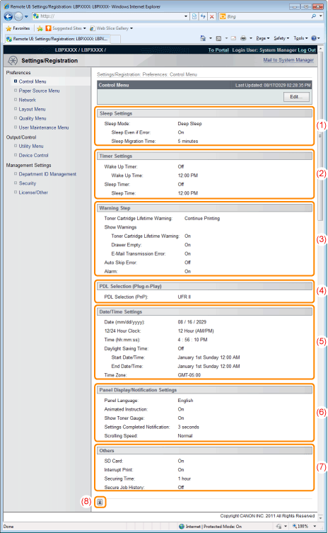

[Control Menu] Page
It displays the operation settings for energy-saving mode (Sleep Mode) and when errors occur.
For details on the settings, see "[Setup] Menu ([Control Menu] Options)."
(1)
[Sleep Settings]
The settings related to sleep mode operation are displayed.
(2)
[Timer Settings]
The settings related to timer operation are displayed.
(3)
[Warning Step]
The settings related to warning display are displayed.
(4)
[PDL Selection (Plug-n-Play)]
The currently selected page description language is displayed.
(5)
[Date/Time Settings]
The settings related to date and time are displayed.
(6)
[Panel Display/Notification Settings]
The settings related to control panel display are displayed.
(7)
[Others]
Other operation settings not included in the above categories are displayed.
(8)
[Back to Page Top]

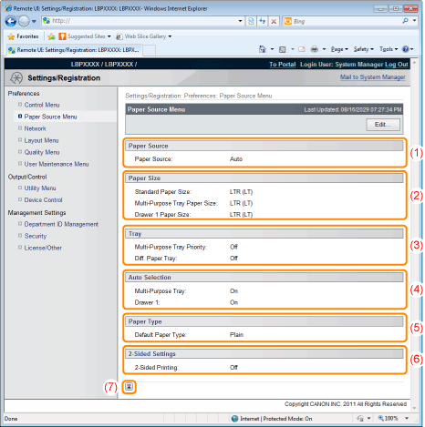

[Paper Source Menu] Page
It displays the settings for paper size, etc. when printing from the multi-purpose tray or paper drawer.
For details on the settings, see "[Setup] Menu ([Paper Source] Options)" or "[Select Feeder] Menu."
(1)
[Paper Source]
The currently selected paper source is displayed.
(2)
[Paper Size]
The paper size selected for each paper source is displayed.
(3)
[Tray]
The operation settings related to the multi-purpose tray are displayed.
(4)
[Auto Selection]
It displays whether to recognize the paper source for auto selection when [Auto] is set for [Paper Source] for each paper source.
(5)
[Paper Type]
The paper type selected for each paper source is displayed.
(6)
[2-Sided Settings]
The settings related to 2-sided printing are displayed.
(7)
[Back to Page Top]
Changing Settings
You can only change settings when you are logged on in system manager mode.

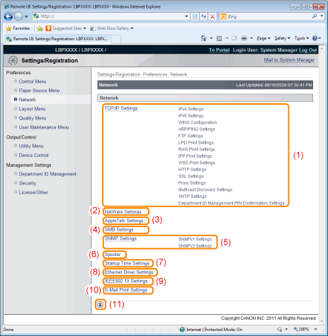

[Network] Page
It displays the printer's network settings, etc.
(1)
[TCP/IP Settings]
It displays the TCP/IP settings.
How to change settings
(2)
[NetWare Settings]
It displays the NetWare settings.
(3)
[AppleTalk Settings]
It displays the AppleTalk settings.
(4)
[SMB Settings]
It displays the SMB settings.
(5)
[SNMP Settings]
It displays the SNMP settings.
(6)
[Spooler]
It displays the spool function settings when the SD card is installed.
(7)
[Startup Time Settings]
It displays the startup time settings.
(8)
[Ethernet Driver Settings]
It displays the network interface settings.
(9)
[IEEE802.1X Settings]
It displays IEEE802.1X security settings.
(10)
[E-Mail Print Settings]
It displays the e-mail print settings.
(11)
[Back to Page Top]

[Layout Menu] Page
It displays the settings relating to print appearance, such as adjustment of print position and setting gutter margins.
For details on the settings, see "[Setup] Menu ([Layout] Options)."
(1)
[Layout Menu]
The settings for number of pages and print appearance are displayed.
(2)
[Back to Page Top]
Changing Settings

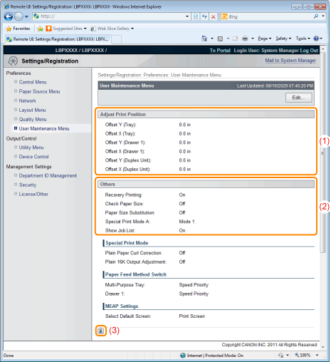

[User Maintenance Menu] Page
It displays the settings for printer adjustment from a specified paper source if a problem occurs, such as adjustment of print position and recovery printing.
For details on the settings, see "[Setup] Menu ([User Maintenance] Options)."
(1)
[Adjust Print Position]
It displays the print position adjustment settings for each paper source.
(2)
[Others]
It displays the settings for operation and maintenance if a problem occurs.
(3)
[Back to Page Top]
Changing Settings

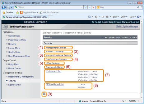

[Security] Page
It displays printer information and security settings.
(1)
It displays general information about the printer.
(2)
[Remote UI Settings]
It displays whether the Remote UI is set to use the SSL encrypted communication function.
(3)
[Key and Certificate Settings]
It displays information on registered keys and certificates.
(4)
[CA Certificate Settings]
(5)
[IPSec Settings]
It displays the IPSec security policy list.
(6)
[Display Job History]
It displays whether it is set to allow job history to be displayed.
(7)
[IP Address Filter]
It displays information restricting users who can print and change settings.
(8)
[MAC Address Filter]
It displays information restricting users who have access.
(9)
[Back to Page Top]
Changing the settings

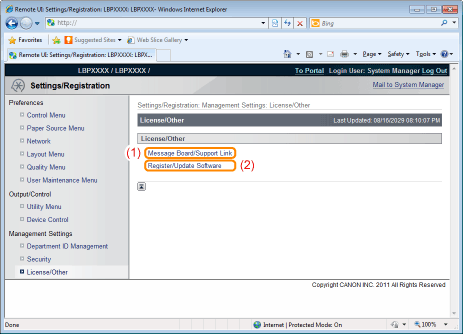

[License/Other] Page
It displays the pages that the settings for message boards or support links, or registering or updating software are performed.
(1)
[Message Board/Support Link]
It displays messages from the administrator and links to support pages.
(2)
[Register/Update Software]
It displays the pages that registering or updating software is performed.
