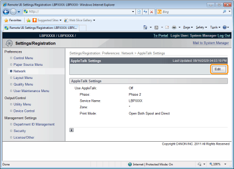

4
Click [AppleTalk Settings].
5
Click [Edit...].
