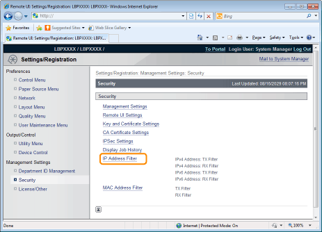

3
Select [Security] from the [Management Settings] menu.
4
Click [IP Address Filter].

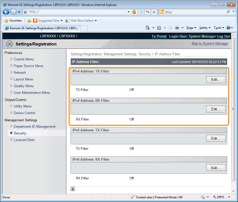

5
Click [Edit...] under [IPv4 Address: TX Filter] or [IPv4 Address: RX Filter].
It limits the sending of data from the printer.
It limits the sending of data to the printer.

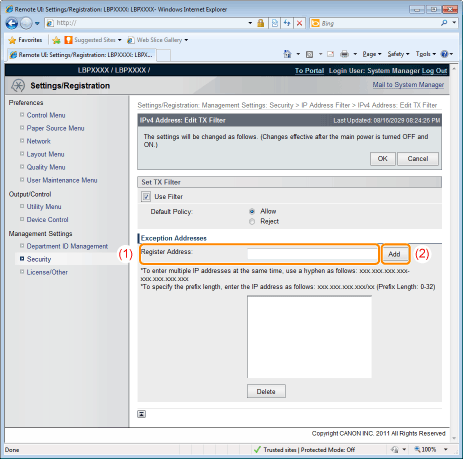

7
Set the IP address.
(1)
Enter the IP address for which you want to reject or permit to print.
Enter the IPv4 address, which is a decimal value, by adding "." (periods) as delimiters.
(2)
Click [Add].
You can set up to 16 IP addresses (16 sets of IP addresses for when you have specified with [Register Address]).
You can also enter IP addresses as follows.
Input example of
the IP addresses
Method for entering IP addresses
192.168.0.1-192.168.0.10
If you want to enter the IP addresses of consecutive numbers, place "-" (hyphen) between the address of the smallest number and that of the largest number.
192.168.0.0/16
In order to specify the subnet range (prefix length), enter a "/" (slash) after the normal IP address symbol, and then enter another prefix length (maximum 32).
When "0" is entered in [Prefix Length]
All the IP addresses become the target for rejection or permission.
When "32" is entered in [Prefix Length]
The IP address of the printer becomes the target for rejection or permission.

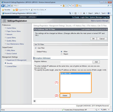

When deleting a set IP address
(1)
Select an IP address you want to delete.
(2)
Click [Delete].

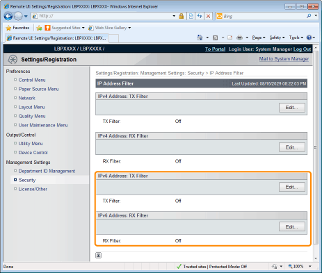

5
Click [Edit...] under [IPv6 Address: TX Filter] or [IPv6 Address: RX Filter].

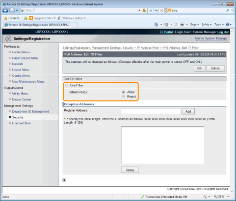

6
Select the [Use Filter] check box, and then select [Default Policy].
If you select [Reject], you will only be able to transmit or print from users (clients) entered in the [Exception Addresses] field.
If you select [Allow], you will not be able to transmit or print from users (clients) entered in the [Exception Addresses] field.
If you clear the [Use Filter] check box, you will be able to transmit and print from all users (clients).
7
Set the IP address.
(1)
Enter the IPv6 address, which is a hexadecimal value, by adding ":" (colons) as delimiters.
(2)
Click [Add].
Input example of
the IP addresses
fe80::0000/64
In order to specify the subnet range (prefix length), enter a "/" (slash) after the normal IP address symbol, and then enter another prefix length (maximum 128).
When "128" is entered in [Prefix Length]
