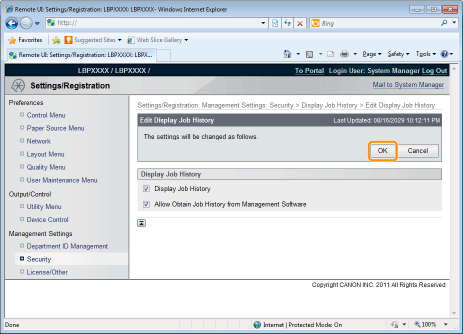

1
Start the Remote UI, and then log in as Administrator.
2
Click [Settings/Registration].
3
Select [Security] from the [Management Settings] menu.
4
Click [Display Job History].
5
Click [Edit...].
6
Specify whether the printer should display the job logs.
If the [Display Job History] check box is selected, you can display the job logs*.
If the [Display Job History] check box is cleared, the job logs* are not displayed.
The [Status Monitor/Cancel] page in the [Job History] menu
7
Select whether to permit management software to obtain job logs.
If the [Allow Obtain Job History from Management Software] check box is selected, you can obtain the job logs from management software.
If the [Allow Obtain Job History from Management Software] check box is cleared, job logs cannot be obtained from management software.
The [Allow Obtain Job History from Management Software] check box is selected automatically.
8
Click [OK].
