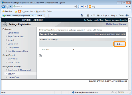

1
Start the Remote UI, and then log in as Administrator.
2
Click [Settings/Registration].
3
Select [Security] from the [Management Settings] menu.
4
Click [Remote UI Settings].
5
Click [Edit...].
6
Change the Remote UI settings.
(1)
Select the [Use SSL] check box.
If you clear the check box, the remote UI cannot use SSL encrypted communication.
(2)
Click [OK].
IMPORTANT
If you cannot set [Use SSL]
When a key is not selected for SSL, [Use SSL] cannot be checked.
7
Perform a hard reset or restart the printer.
After performing a hard reset or restarting the printer, the settings are effective.
