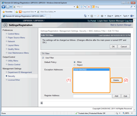

When deleting a set MAC address
(1)
Select a MAC address you want to delete.
(2)
Click [Delete].
