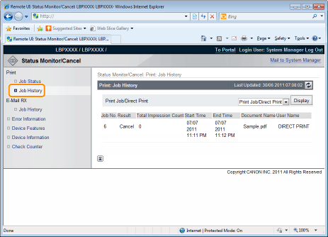

Checking Job History
1
Start the Remote UI.
2
Select [Job History] from the [Status Monitor/Cancel] menu.
3
Select the options that you want to display.
[Print Job/Direct Print]:
The printed job history is displayed from the computer.
[Stored Job]:
The printing history of jobs stored in BOX is displayed.
[Report]:
The utility print printing history is displayed.
[E-Mail Print]:
The history of jobs received by e-mail and printed is displayed.
