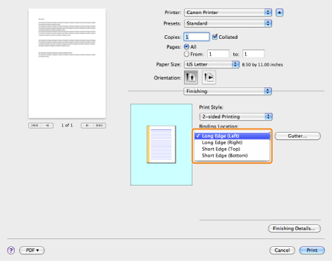

1.
Select [Print] from the [File] menu of the application.
2.
Select your printer from [Printer] → [Finishing] → Select [1-sided Printing] or [2-sided Printing] from [Print Style].
The default setting for [Print Style] is [2-sided printing]. You can save the 1-sided printing setting as a preset. For details, see "Using [Presets] for Printing."
3.
Select the binding edge from [Binding Location].
The output image is displayed in the preview area.
4.
If you want to set the gutter width, click [Gutter].
If you do not set the gutter width, skip to step 6.
5.
Specify the gutter width → click [OK].
6.
Click [Print].
The screen may vary according to the operating system, as well as the type and version of the printer driver.
