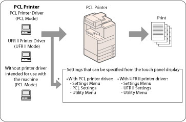

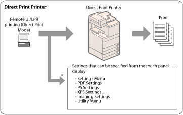

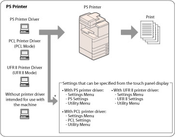

Top » Print » Setting the Machine (PS/PCL/UFR II Printer) » Differences in Operation with UFR II, PCL, PS, and Direct Print Printers
06RH-1C7
This describes differences in the settings that can be specified as a minimum from the touch panel display in each printer type.
*An asterisk (*) indicates settings which are not specifiable with the printer driver or a Remote UI that can be specified from the touch panel display.
