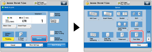

1.
Press (Main Menu) → [Access Stored Files].
2.
Select the desired Mail Box → select the desired file → press [Print].
3.
Press [Change Print Settings].
4.
Press [Options] → [Print Date].
