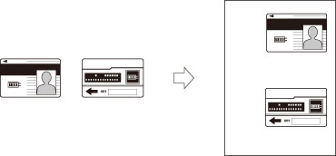

Copying performed using [Copy ID Card] always results in a print that resembles the following illustration.
