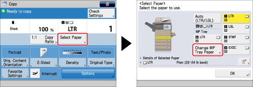

Press [Select Paper] → [Change MP Tray Paper].
The paper size/type reserved to be loaded and paper size/type currently loaded appear in the paper selection screen, as shown below.
