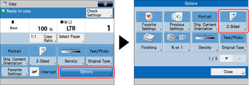

Press [Copy].
2.
Press [Options] → [2-Sided].
