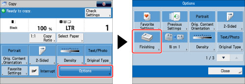

Specifying the Finishing Mode
1.
Press [Copy].
2.
Press [Options] → [Finishing].
3.
Set the desired finishing mode.
