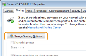

      Click the [Sharing] tab, select [Share this printer], and enter the share name of the machine.
      NOTE:
      When [Change Sharing Options] is displayed
      Click [Change Sharing Options]. If the [User Account Control] dialog box appears, click [Yes] (or [Continue]).
