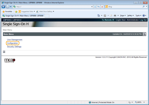

Click [Configuration].

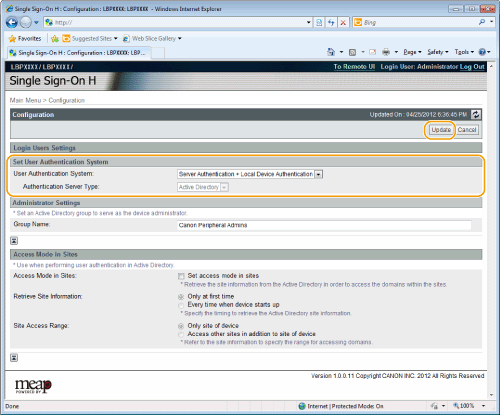

Select each item in <Set User Authentication System> → click [Update].
[User Authentication System]
[Server Authentication]
Uses only Server Authentication.
[Server Authentication + Local Device Authentication]
Uses both Server Authentication and Local Device Authentication.
[Local Device Authentication]
Uses only Local Device Authentication.
[Authentication Server Type]
[Active Directory]
Uses authentication that is performed in a Windows domain environment.
