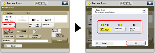

As an example, the procedure for selecting a mail box as the storage location is explained in this section.
1.
Press (Main Menu) → [Scan and Store] → [Mail Box].
2.
Select the desired Mail Box → press [Scan].
3.
Press [Select Color] → select the color mode → press [OK].

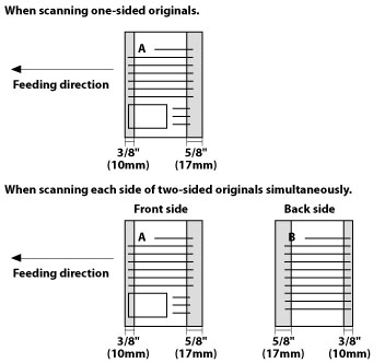

If the color sections are located only in the range indicated by the diagram below, when loading the originals in the feeder
