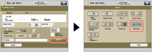

As an example, the procedure for selecting a mail box as the storage location is explained in this section.
1.
Press
(Main Menu) → [Scan and Store] → [Mail Box].
2.
Select the desired Mail Box → press [Scan].
3.
Press [Options] → [Sharpness].
4.
Adjust the sharpness.
If the storage location is the Mail Box:
Press [Low] or [High] to adjust the sharpness for the Text and Photo/Image areas.
To scan text or lines clearly, the setting should be towards [High] for <Text>. To scan originals containing printed photographs or other halftones, the setting should be towards [Low] for <Photo/Image>.
If the storage location is the Memory Media:
Press [Low] or [High] to adjust the sharpness.
To scan text or lines clearly, the setting should be towards [High]. To scan originals containing printed photographs or other halftones, the setting should be towards [Low].
5.
Press [OK] → [Close].
