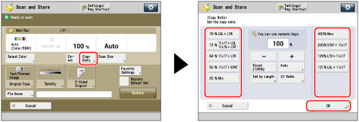

Preset Zoom
You can use preset copy (zoom) ratios to enlarge or reduce standard size originals to other standard sizes.
1.
Press (Main Menu) → [Scan and Store] → [Mail Box].
2.
Select the desired Mail Box → press [Scan].
3.
Press [Copy Ratio] → select the desired zoom ratio → press [OK].

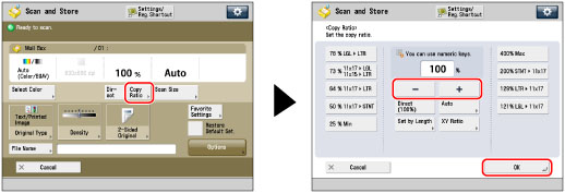

Zoom by Percentage
You can enlarge or reduce originals by any zoom ratio in 1% increments. The available zoom ratios are from 25% to 400% for the Mail Box function, and from 50% to 200% for the Memory Media function. The same zoom ratio is used for the horizontal and vertical axes.
1.
2.
3.
Press [Copy Ratio] → adjust the zoom ratio using [-] and [+] → press [OK].

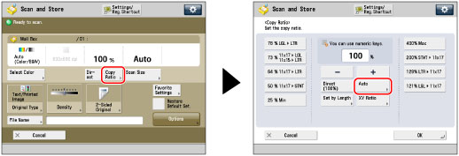

Auto Ratio
Select this mode to have the machine automatically select the zoom ratio based on the selected record size. The available zoom ratios are from 25% to 400% for the Mail Box function, and from 50% to 200% for the Memory Media function. The same zoom ratio is used for the horizontal and vertical axes.
1.
2.
3.
Press [Copy Ratio] → [Auto].
4.
Select the desired data output size → press [OK].

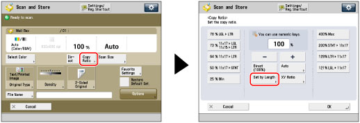

1.
2.
3.
Press [Copy Ratio] → [Set by Length].
4.
Set the horizontal and vertical copy (zoom) ratio for the original size and record size.
If you do not want to change the horizontal and vertical copy ratio, select [XY Same Ratio]. To change the copy ratio, select [XY Independent].

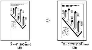

You can set the same copy (zoom) ratio for both the horizontal (X) and vertical (Y) axes.
Press [XY Same Ratio].
Press [Original Size] → enter a value.
Press [Data Output Size] → enter a value.
You can enter the width or length of the original size. If you enter the width for the original size, make sure to enter the width for the output size, and vice versa.

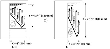

If you select [XY Independent]:
You can set different copy (zoom) ratios for the horizontal (X) and vertical (Y) axes.
Press [XY Independent].
Press [X] and [Y] for <Original Size> → enter each value.
Press [X] and [Y] for <Data Output Size> → enter each value.
