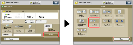

1.
Press (Main Menu) → [Scan and Store] → [Mail Box].
2.
Select the desired Mail Box → press [Scan].
3.
Press [Options] → [Job Build] → [Close].
4.
Press (Start).
