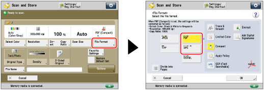

Press (Main Menu) → [Scan and Store] → [Memory Media].
2.
Select the desired memory media → select the destination directory → press [Scan].
3.
Press [File Format] → select PDF or XPS.
4.
Press [Compact] → [OK].
