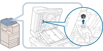

For the imageRUNNER ADVANCE C5255/C5250
1.
Open the feeder.
2.
Pull the lever above the feeder, and open the document scan cover.
IMPORTANT
Open the document scan cover carefully, as not to scratch the platen glass.
3.
Open the stamp cover.
4.
Remove the old stamp cartridge.
5.
Push in the new stamp cartridge until it clicks.
IMPORTANT
Insert the stamp cartridge so that it is not slanted.
Insert the stamp cartridge properly, or paper jams may occur.
6.
Close the stamp cover.
CAUTION
When closing the cover, be careful not to get your fingers caught, as this may result in personal injury.
7.
Close the cover of the document scanning area until it clicks.
CAUTION
8.
Close the feeder.
CAUTION
When closing the feeder, be careful not to get your fingers caught, as this may result in personal injury.
Be aware that the light emitted from the platen glass may be very bright when closing the feeder.
