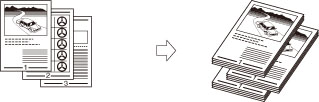

When printing multiple copies of a file, you can collate the output into separate prints.
Example: Three prints of each page collated in page order
Press [Collate (Page Order)] → [OK].

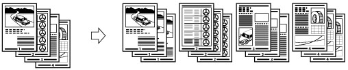

When printing multiple copies of a file, you can group each page together.
Example: Three prints of each page grouped by page
Press [Group (Same Pages)] → [OK].
