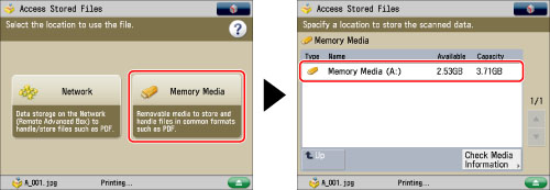

1.
Press [Access Stored Files].
If the pop-up screen indicating that the machine is printing or waiting to print is displayed, press [Close].
2.
Press [Memory Media] → select the desired memory media.
3.
Select the location where the file you want to print is stored → select the desired file → press [Print].
