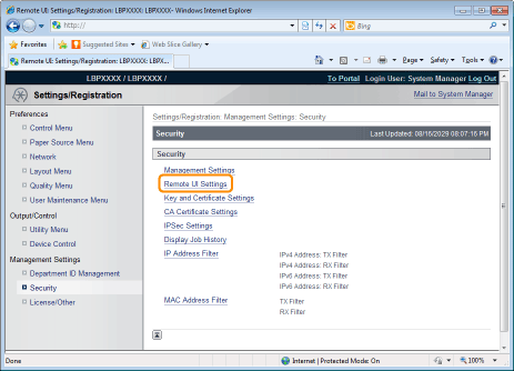

Select [Security] from the [Management Settings] menu.
4
Click [Remote UI Settings].

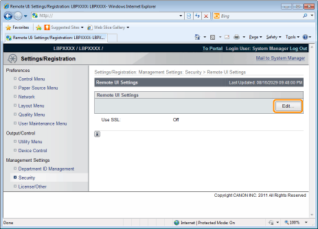

Click [Edit...].
