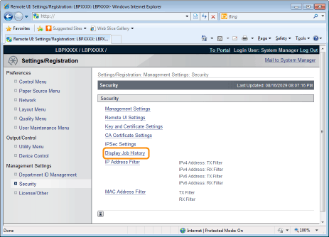

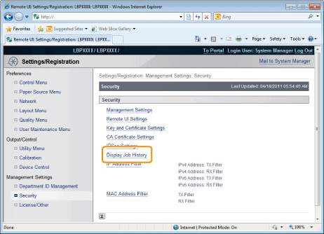

Click [Display Job History].
5

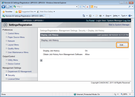

Click [Edit...].
6

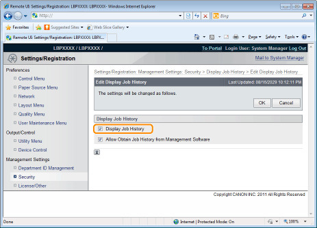

Specify whether the printer should display the job logs.
If the [Display Job History] check box is selected, you can display the job logs*.
If the [Display Job History] check box is cleared, the job logs* are not displayed.
The [Job History] page in the [Status Monitor/Cancel] menu
7
Select whether to permit management software to obtain job logs.
If the [Allow Obtain Job History from Management Software] check box is selected, you can obtain the job logs from management software.
If the [Allow Obtain Job History from Management Software] check box is cleared, job logs cannot be obtained from management software.
The [Allow Obtain Job History from Management Software] check box is selected automatically.
