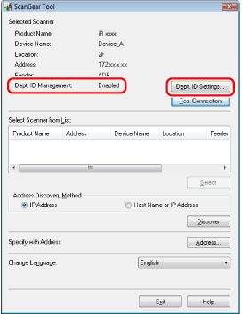

2.
Confirm that [Enabled] is displayed for [Dept. ID Management] → click [Dept. ID Settings].
3.
Select [Confirm Department ID/PIN when Scanning] → click [OK].
