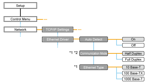

When configuring the interface using the printer's control panel, use the following menu hierarchy.
*1
[Communication Mode] and [Ethernet Type] are displayed when [Auto Detect] is set to [Off].
*2
[Communication Mode] appears only when [Ethernet Type] is set to a setting other than [1000 Base-T].
Pressing [ ] (Settings) displays the common Setup menu.
indicates that the procedure is performed by pressing [ ] or [  ] on the control panel.
indicates that the procedure is performed by pressing [OK] on the control panel.

1
Press [  ] (Settings), select [Network] using [ ] and [  ], and then press [OK].
When the message is displayed, press [OK].
You can specify the settings when the printer is either online (the Online indicator is on) or offline (the Online indicator is off).
2
Select [Ethernet Driver] using [ ] and [  ], and then press [OK].
3
Configure the Ethernet driver.
This printer can detect the communication method and Ethernet type automatically. Normally, set [Auto Detect] to [On].
If you want to fix the communication method and Ethernet type, set [Auto Detect] to [Off].
If you are using a hub, match the settings for the hub and the printer. For the settings of the hub you are using, consult your network administrator.
(Example)
Hub settings
Communication mode: Full duplex
Ethernet type: 10 Base-T
Printer settings
[Auto Detect]: [Off]
[Communication Mode]: [Full Duplex]
[Ethernet Type]: [10 Base-T]
When detecting the Ethernet driver automatically (Default)
(1)
Select [Auto Detect] using [ ] and [  ], and then press [OK].
(2)
Select [On] using [ ] and [  ], and then press [OK].
When detecting the Ethernet driver manually
(1)
(2)
Select [Off] using [ ] and [  ], and then press [OK].
(3)
Select [Communication Mode] using [ ] and [  ], and then press [OK].
(4)
Select an Ethernet communication method appropriate for your network environment using [ ] and [  ], and then press [OK].
[Half Duplex]:
Receives and transmits data alternately, not simultaneously.
[Full Duplex]:
Receives and transmits data simultaneously.
(5)
Select [Ethernet Type] using [ ] and [  ], and then press [OK].
(6)
Select an Ethernet type appropriate for your network environment using [ ] and [  ], and then press [OK].
4
Perform a hard reset or restart the printer.
After performing a hard reset or restarting the printer, the settings are effective.
