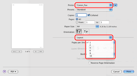

1.
Select [Print] from the [File] menu of the application.
2.
Select your fax → [Layout] → the number of pages you want to output onto one sheet of paper from [Pages per Sheet].

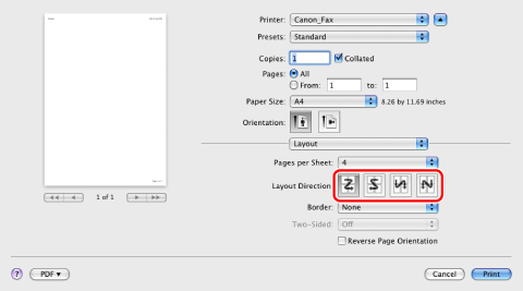

3.
Select the page order from [Layout Direction].

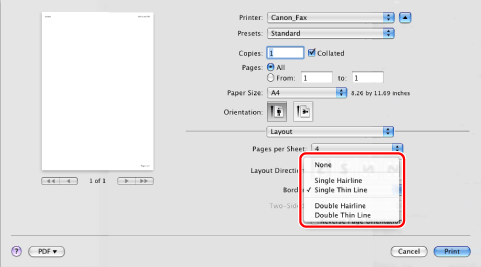

4.
If you want to add a border to each page, select the line type from [Border].
