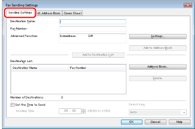

Click [Sending Settings].
See "Faxing" on how to display the fax driver screen.

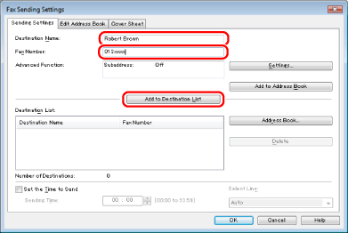

Specify the recipient name and fax number → click [Add to Destination List].
You can select the destination from the address book. For details about selecting a destination from the address book, see "Faxing."
If you have selected [Reenter Fax Number before adding Destination to [Destination List]] in the [Security Settings] dialog box of the [Special] sheet, the [Confirm Destination] dialog box is displayed when you click [Add to Destination List]. For details, see the online help (see "Viewing the Online Help").

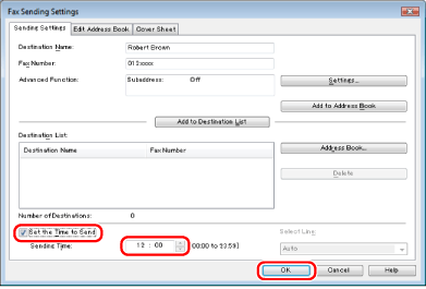

Select [Set the Time to Send] → specify the time to send the fax → click [OK].
The data is stored temporarily in the machine, and the fax is sent at the specified time.
