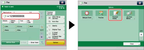

Finished Stamp
The machine can print a stamp (approximately 1/8" (3 mm) in diameter) on the front side of scanned and sent originals.
For information on the optional products required to use this function with the imageRUNNER ADVANCE 4035/4025, see "Optional Products Required for Each Function."
Vertical Placement
Horizontal Placement
IMPORTANT
Place your originals in the feeder. The finished stamp is applied to the originals that are scanned from the feeder.
1.
Press [Fax].
2.
Specify the destination → press [Options] → [Finished Stamp].
If the stamp does not print correctly, see "Replacing the Stamp Cartridge (Feeder)."
3.
Press [Close].
