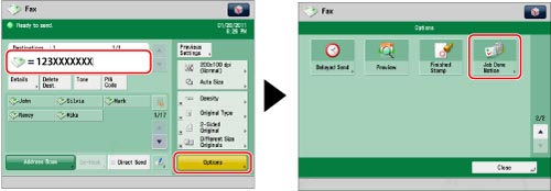

Job Done Notice
You can send a job done notice to a specified e-mail address to notify you when a send job is complete.
To send a job done notice, you need to store the e-mail address in the Local Address Book or one-touch button beforehand. (See "Registering an E-Mail Address.")
1.
Press [Fax].
2.
Specify the destination → press [Options] → [Job Done Notice].
3.
Select the destination for the job done notice → press [OK].
For instructions on searching for destinations registered in the Address Book, see "Address Book Screen."
4.
Press [Close].
