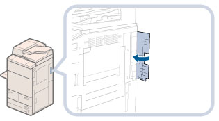

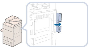

1.
Push and open the right cover of the machine.

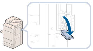

2.
Open the front cover of the Removable HDD Kit.
If the front cover is locked, unlock the front cover.
3.
Hold the handle on the hard disk holder and being careful of the orientation, insert the holder in until it clicks.

1.
2.
3.
Hold the handle on the hard disk holder and remove the holder.
