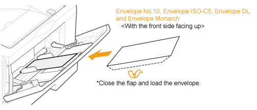

You can load envelopes only in the multi-purpose tray.
<Precautions when loading envelopes>
Load envelopes in the correct orientation as follows.
(: Feeding direction)
Before loading envelopes, align them as follows.
