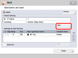

Specifying the Finishing Mode
1.
Press [Hold].
2.
Select the desired job → press [Details/Edit] → [Edit/Confirm Job Ticket].
3.
Press [Edit] under <Overall Settings>.
4.
Press [Finishing].
5.
Set the desired finishing mode.
Select [Collate (Page Order)], [Group (Same Pages)], or [Staple].
