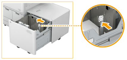

Slide the rear edge retainer until it does not catch on the paper to set.
The rear edge retainer slides by holding.

Squeeze the lever. Without releasing the lever, slide the outer size change plate and inner size change plate until it does not catch on the paper to set.

Slide the rear edge retainer to align it with the desired paper size, as shown below.
IMPORTANT:
If the rear edge retainer is not aligned properly, paper may become jammed, the quality of the image may be degraded, or the inside of the machine may become dirty. Make sure to load paper with the rear edge retainer properly aligned with the paper size marks on the top and base of the paper deck.
