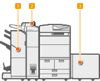

      Location of the Paper Jam
      If a paper jam occurs, the location of the jam and solutions are displayed on the touch panel display. Follow the on-screen instructions to solve the problem. For details on how to clear the paper jams, see the following sections.
      Main unit
      When Staple Finisher-V1/Booklet Finisher-V1 is attached
      When Copy Tray-R1 is attached
