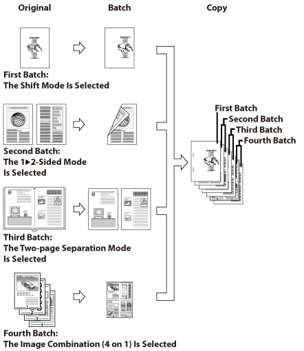

This mode enables you to scan multiple batches of originals with different copy settings and print them as one document.
You can set copy settings (for example, the Add Cover, Insert Sheets, and Page Numbering modes) for the combined document. You can also store the combined document in a Mail Box.
As an example, the procedure for double stapling and setting a front cover for the combined document is described in this section.

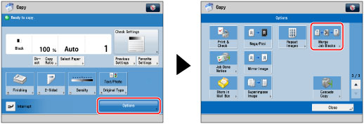

1.
Press [Copy].
2.
Press [Options] → [Merge Job Blocks].
3.
Specify the copy settings for the combined document → press [OK].

Select the batches of originals in the order in which you want to combine them.

The selected batches are numbered and combined in the specified order.
You can cancel a selection by selecting the batch of originals again.
