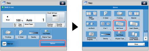

1.
Press [Copy].
2.
Press [Options] → [Add Cover].
3.
Select the type of cover and printing → press [OK] → [Close].
To select the paper for the front and back cover, press [Change] for <Select Paper> → select the paper → press [OK].
