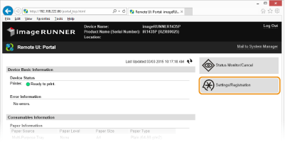

      1
      Start the Remote UI and log on in System Manager Mode. Starting the Remote UI
      2
      Click [Settings/Registration].

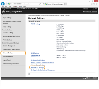

      3
      Click [Network Settings]  [IEEE 802.1X Settings].

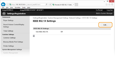

      4
      Click [Edit...].

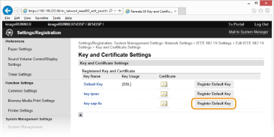

      1
      Select the [Use TLS] check box and click [Key and Certificate...].
      2
      Click [Register Default Key] on the right of the key pair you want to use for the client authentication.
      NOTE:
      Viewing details of a key pair or certificate
      You can check the details of the certificate or verify the certificate by clicking the corresponding text link under [Key Name], or the certificate icon. Verifying Key Pairs and Digital Certificates

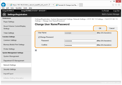

      2
      Click [Change User Name/Password].
      To specify a user name other than the login name, clear the [Use Login Name as User Name] check box. Select the check box if you want to use the login name as the user name.
      3
      Set the user name/password and click [OK].
      [User Name]
      Enter up to 24 alphanumeric characters for the user name.
      [Change Password]
      To set or change the password, select the check box and enter up to 24 alphanumeric characters for the new password both in the [Password:] and [Confirm:] text boxes.
