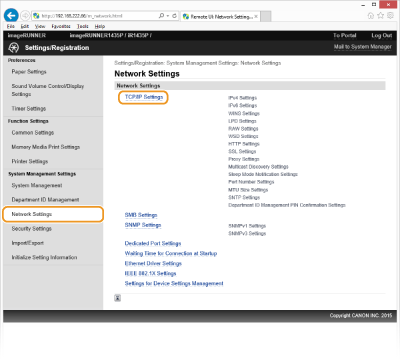

      Click [Network Settings]  [TCP/IP Settings].
      4

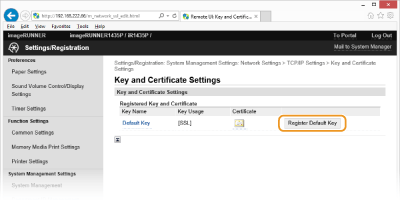

      Click [Key and Certificate...] in [SSL Settings].
      5
      Click [Register Default Key] on the right of the key pair you want to use.

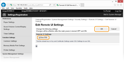

      Enable SSL for the Remote UI.
      1
      Click [Security Settings] [Remote UI Settings].
      2
      Click [Edit...].
      3
      Select the [Use SSL] check box and click [OK].
