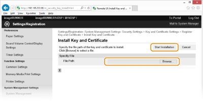

      6
      Click [Browse...], specify the file to install, and click [Start Installation].
      The key pair or CA certificate is installed in the machine.
