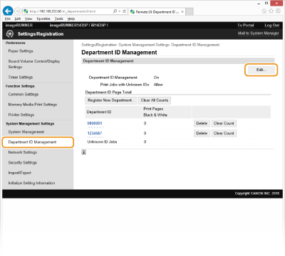

      Click [Settings/Registration].
      3
      Click [Department ID Management] and register (or edit) Department IDs.
      Registering a Department ID
      1
      Click [Register New Department...].
      2
      Specify the required settings and click [OK].

      1
      Click the corresponding text link under [Department ID:] to edit.
      2
      Change the settings as necessary and click [OK].

      [Department ID Page Total]
      You can check the total numbers of pages printed for each Department ID.
      If you want to return the counts to zero, click the corresponding text link under [Department ID:] and click [Clear Count]  [OK]. If you want to return the counts of all Department IDs to zero, click [Clear All Counts]  [OK].
      3
      Click [Department ID Management]  [Edit...].
      4
      Select the [Department ID Management] check box and click [OK].

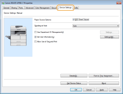

      1
      Open the printer folder. Displaying the Printer Folder
      2
      Right-click your printer icon and click [Printer properties] (or [Properties]).
      3
      Click the [Device Settings] tab and specify the required settings.
      1
      Select the [Use Department ID Management] check box and click [Settings] on the right of it.
      2
      Specify the settings as necessary and click [OK].
      [Allow PIN Setting]
      Select the check box to enable the PIN setting.
      [Department ID]
      Enter a number of up to seven digits for the Department ID.
      [PIN]
      Enter a number of up to seven digits for the PIN if it is set for the Department ID.
      [Verify]
      Click to verify that the correct ID and PIN are entered. This function is not available if the machine and the computer are connected via a USB or WSD (Web Services on Devices) port.
      [Confirm Department ID/PIN When Printing]
      Select the check box to display the [Confirm Department ID/PIN] pop-up screen each time you print from a computer.
      [Authenticate Department ID/PIN at Device]
      Select the check box if the machine and the computer are connected via a USB or WSD port.
      3
      4
      Clear the check boxes as necessary and click [OK].
